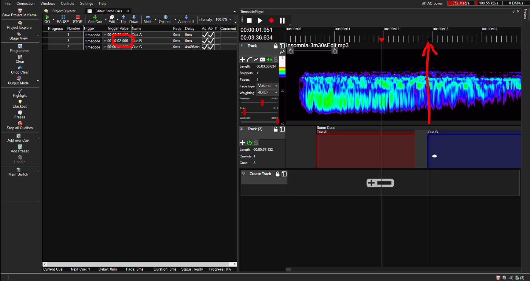

Issue 1:
Adjusting the cue start time in the Timecode player seems very erratic and inaccurate.
See this video: https://vimeo.com/904891438/2e89a27c8b?share=copy
I slowly drag the “Cue B” start time across the timeline.
As I drag, the display is very jumpy/flickering. The cue start time value in the cuelist window is gradually incrementing as I drag, but it is not showing the same time as the position of the cue in the Timecode Player window.
I’ve attached a screenshot which shows that as I’m dragging the cue start time over the ~3 second mark in the Timecode Player, the value displayed in the Cuelist editor is 00:00:02.006
I think this is a different issue to FS#5239 which described the cuelist times working in frames rather than milliseconds which is why I’m reporting it.
